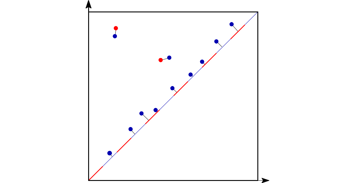

The bottleneck distance measures the similarity between two persistence diagrams. It is the shortest distance b for which there exists a perfect matching between the points of the two diagrams (completed with all the points on the diagonal in order to ignore cardinality mismatchs) such that any couple of matched points are at distance at most b, where the distance between points is the sup norm in \(\mathbb{R}^2\) (not the Euclidean distance).
On this picture, the red edges represent the matching. The bottleneck distance is the length of the longest edge.

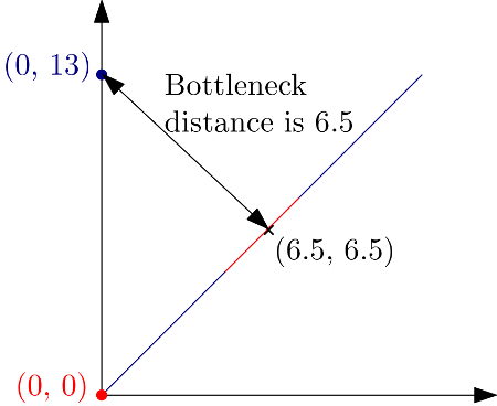

Bottleneck distance = 6.5
The point (0, 13) is at distance 6.5 from the diagonal and more specifically from the point (6.5, 6.5)
