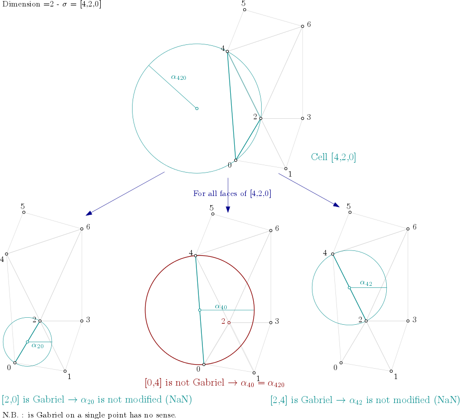

for i : dimension 0 dofor all σ of dimension iif filtration(σ) is NaN thenfiltration(σ)=α2(σ)end iffor all τ face of σ do// propagate alpha filtration valueif filtration(τ) is not NaN thenfiltration(τ) = min( filtration(τ), filtration(σ) )elseif τ is not Gabriel for σ thenfiltration(τ) = filtration(σ)end ifend ifend forend forend formake_filtration_non_decreasing()prune_above_filtration()
Dimension 2
From the example above, it means the algorithm looks into each triangle ([0,1,2], [0,2,4], [1,2,3], ...), computes the filtration value of the triangle, and then propagates the filtration value as described here :
Filtration value propagation example
Dimension 1
Then, the algorithm looks into each edge ([0,1], [0,2], [1,2], ...), computes the filtration value of the edge (in this case, propagation will have no effect).
