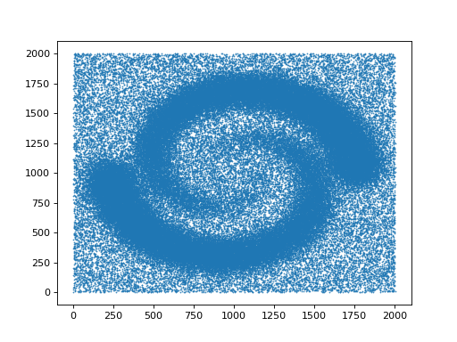

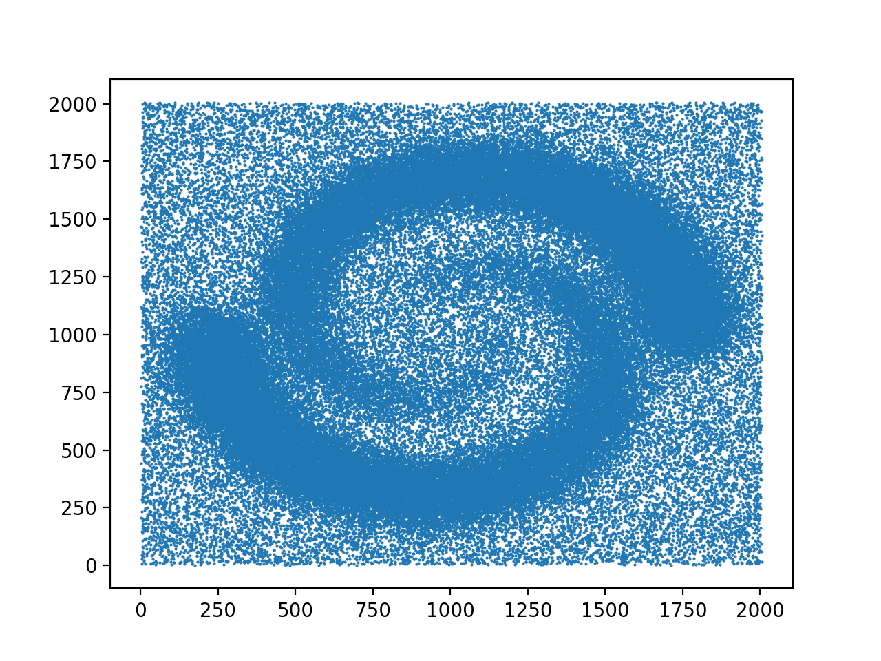

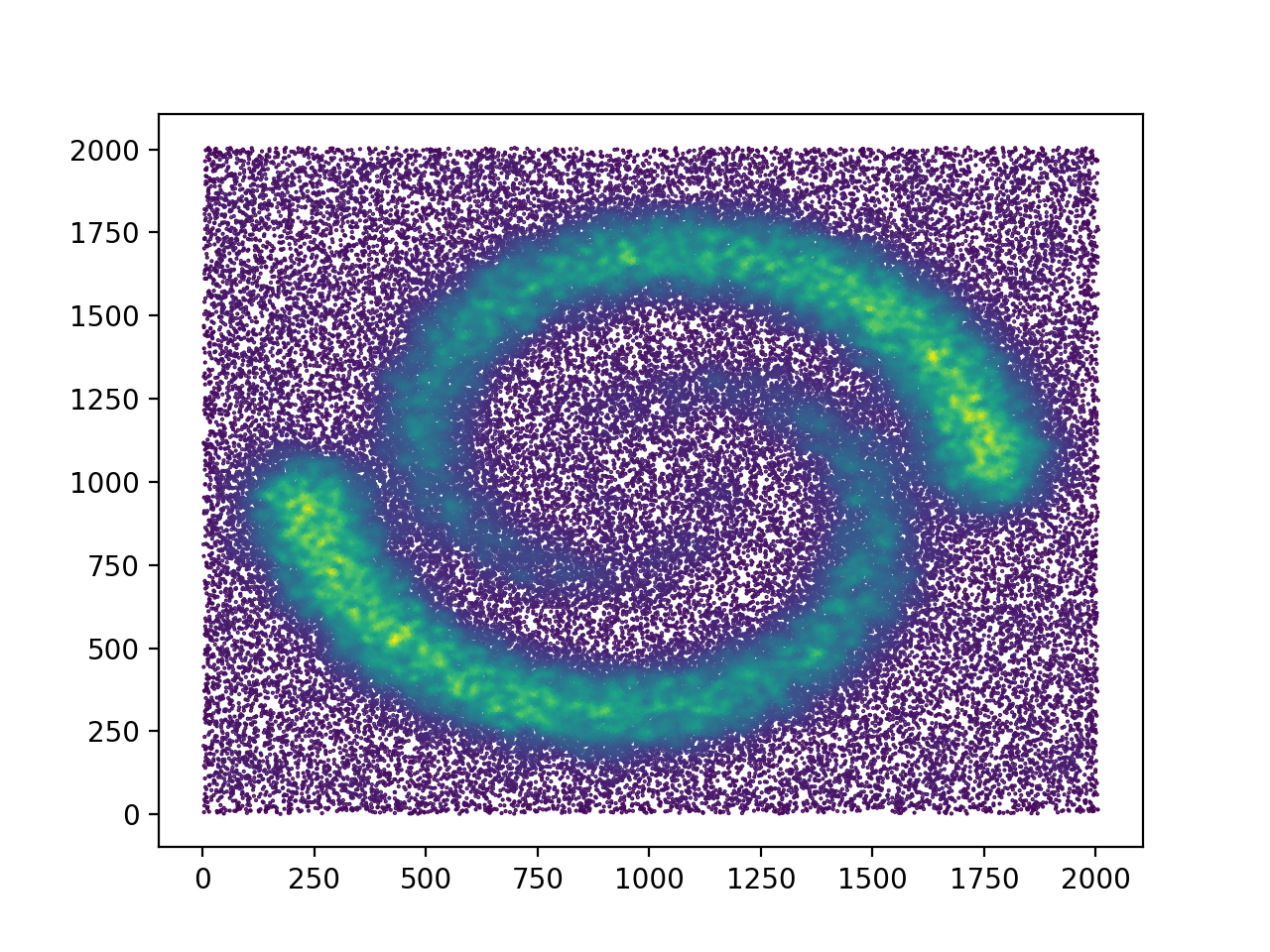

import gudhi
from gudhi.datasets.remote import fetch_spiral_2d
data = fetch_spiral_2d()
import matplotlib.pyplot as plt
plt.scatter(data[:,0],data[:,1],marker='.',s=1)
plt.show()
(Source code, png, hires.png, pdf)

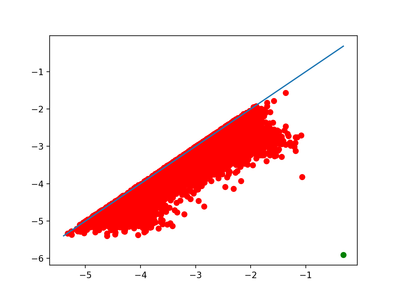

from gudhi.clustering.tomato import Tomato
t = Tomato()
t.fit(data)
t.plot_diagram()

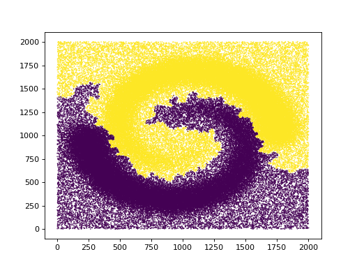

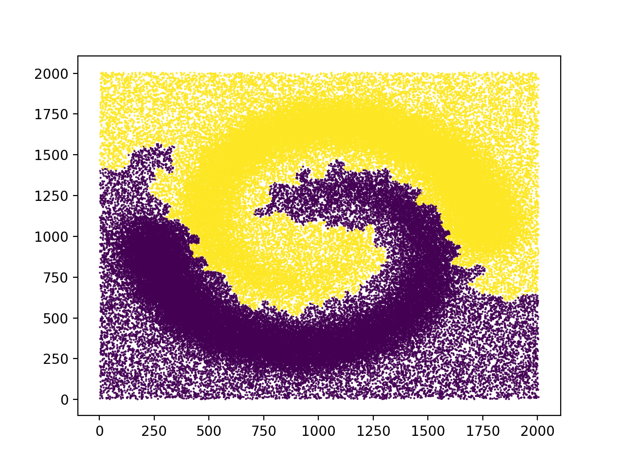

As one can see in t.n_clusters_, the algorithm found 6316 initial clusters. The diagram shows their prominence as their distance to the diagonal. There is always one point infinitely far: there is at least one cluster. Among the others, one point seems significantly farther from the diagonal than the others, which indicates that splitting the points into 2 clusters may be a sensible idea.
t.n_clusters_=2
plt.scatter(data[:,0],data[:,1],marker='.',s=1,c=t.labels_)
plt.show()

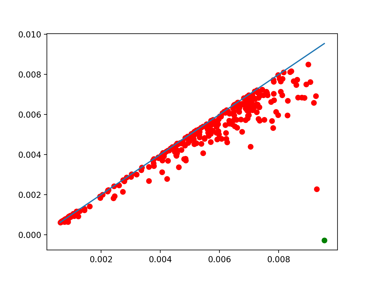

Of course this is just the result for one set of parameters. We can ask for a different density estimator and a different neighborhood graph computed with different parameters.
t = Tomato(density_type='DTM', k=100)
t.fit(data)
t.plot_diagram()
Makes the number of clusters clearer, and changes a bit the shape of the clusters.
