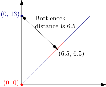

![]() Bottleneck distance is the length of the longest edge¶ |
Bottleneck distance measures the similarity between two persistence
diagrams. It’s the shortest distance b for which there exists a
perfect matching between the points of the two diagrams (+ all the
diagonal points) such that any couple of matched points are at
distance at most b, where the distance between points is the sup
norm in |

Distance computation¶
The following example explains how the distance is computed:
import gudhi
message = "Bottleneck distance = " + '%.1f' % gudhi.bottleneck_distance([[0., 0.]], [[0., 13.]])
print(message)
Bottleneck distance = 6.5
The point (0, 13) is at distance 6.5 from the diagonal and more specifically from the point (6.5, 6.5).¶
