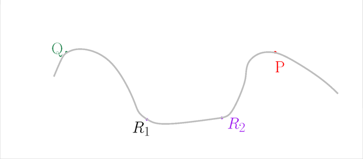

Let us start with the description of the Tangential complex of a simple example, with k=1 and d=2. The point set P is located on a closed curve embedded in 2D. Only 4 points will be displayed (more are required for PCA) to simplify the figures.
The input

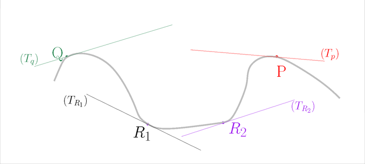

For each point P, estimate its tangent subspace TP using PCA.
The estimated normals

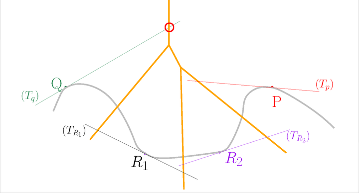

Let us add the Voronoi diagram of the points in orange. For each point P, construct its star in the Delaunay triangulation of P restricted to TP.
The Voronoi diagram
The Tangential Delaunay complex is the union of those stars.

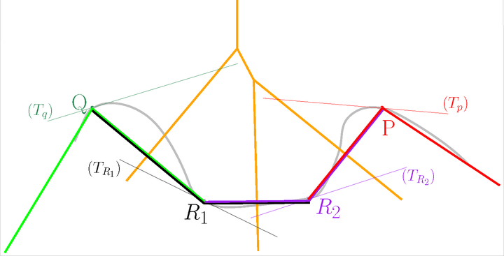

Inconsistencies
Inconsistencies between the stars can occur. An inconsistency occurs when a simplex is not in the star of all its vertices.

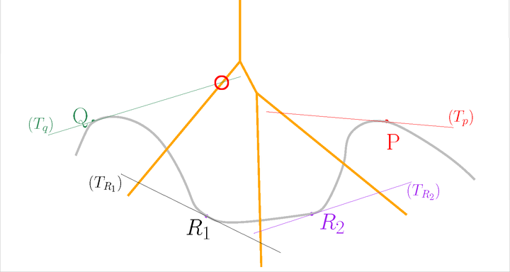

Let us take the same example.
Before

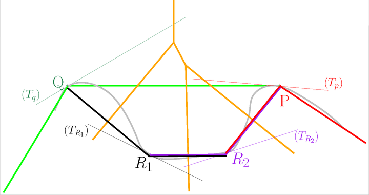

Let us slightly move the tangent subspace TQ
After
Now, the star of Q contains QP, but the star of P does not contain QP. We have an inconsistency.
After
One way to solve inconsistencies is to randomly perturb the positions of the points involved in an inconsistency. In the current implementation, this perturbation is done in the tangent subspace of each point. The maximum perturbation radius is given as a parameter to the constructor.
