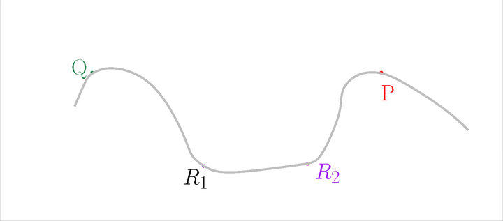

Let us start with the description of the Tangential complex of a simple example, with \( k=1 \) and \( d=2 \). The point set \( \mathscr P \) is located on a closed curve embedded in 2D. Only 4 points will be displayed (more are required for PCA) to simplify the figures.
The input

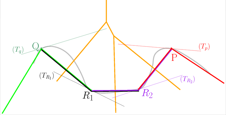

Let us add the Voronoi diagram of the points in orange. For each point \( P \), construct its star in the Delaunay triangulation of \( \mathscr P \) restricted to \( T_P \).
The Voronoi diagram
The Tangential Delaunay complex is the union of those stars.
In practice, neither the ambient Voronoi diagram nor the ambient Delaunay triangulation is computed. Instead, local \( k \)-dimensional regular triangulations are computed with a limited number of points as we only need the star of each point. More details can be found in [4].
