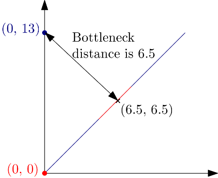

Distance computation
The following example explains how the distance is computed:
#include <gudhi/Bottleneck.h>
#include <iostream>
#include <vector>
#include <utility> // for pair
int main() {
std::vector< std::pair<double, double> > diag1, diag2;
diag1.emplace_back(0., 0.);
diag2.emplace_back(0., 13.);
std::clog << "Bottleneck distance = " << b << std::endl;
double bottleneck_distance(const Persistence_diagram1 &diag1, const Persistence_diagram2 &diag2, double e=(std::numeric_limits< double >::min)())
Function to compute the Bottleneck distance between two persistence diagrams.
Definition: Bottleneck.h:116
Bottleneck distance = 6.5
The point (0, 13) is at distance 6.5 from the diagonal and more specifically from the point (6.5, 6.5)
