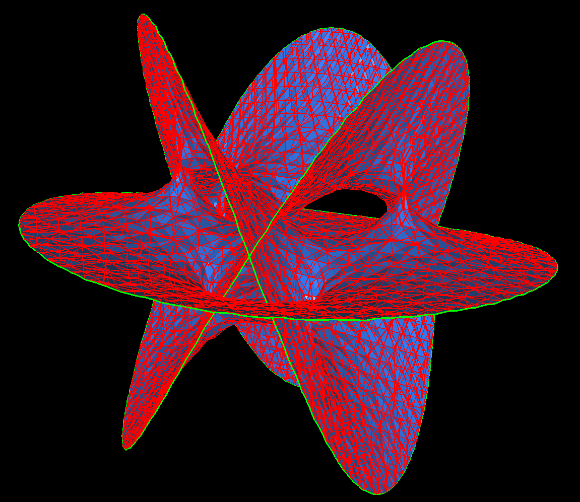

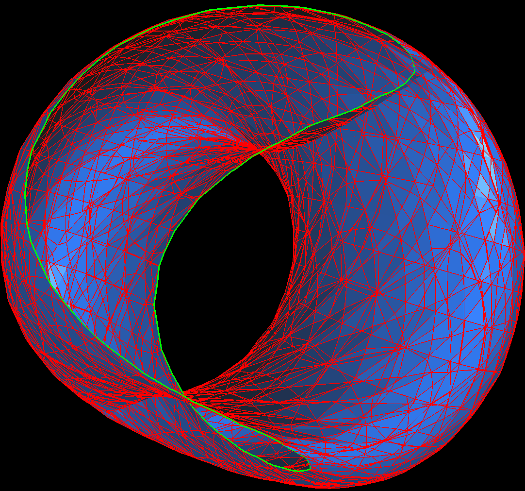

The output in medit is:
In the following more complex example, we define a custom function for the implicit manifold.
The output in medit looks as follows:
