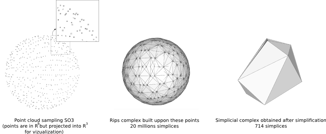

A typical application of this package is homology group computation. It is illustrated in the next figure where a Rips complex is built uppon a set of high-dimensional points and simplified with edge contractions. It has initially a big number of simplices (around 20 millions) but simplifying it to a much reduced form with only 15 vertices (and 714 simplices) takes only few seconds on a desktop machine (see the example bellow). One can then compute homology group with a simplicial complex having very few simplices instead of running the homology algorithm on the much bigger initial set of simplices which would take much more time and memory.
Edge contraction illustration

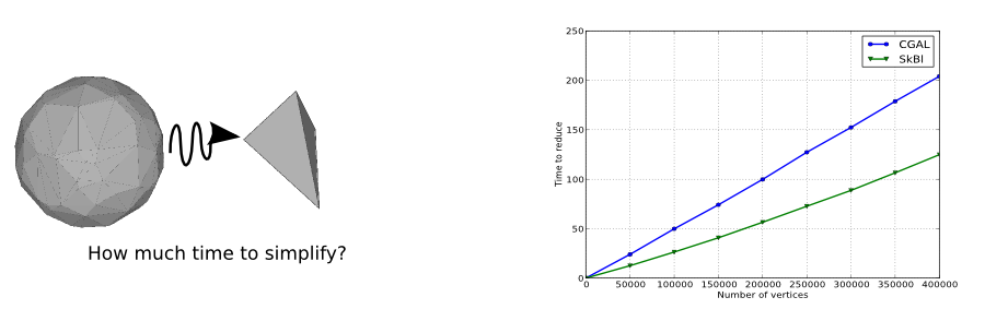

The next figure shows the computation time to reduce a random 2-sphere to a single tetrahedron with this package and with the CGAL equivalent package. Despite this package is able to deal with arbitrary simplicial complexes (any dimensions, manifold or non manifold), it is still 65% times faster than the CGAL package which is focused on 2-manifold. The main reason is that few blockers appears during the simplification and hence, the algorithm only have to deal with the graph and not higher-dimensional simplices (in this case triangles). However, we recall that higher-dimensional simplices are implicitely stored in the Skeleton-Blocker data-structure. Hence, one has to store simplices in an external map if some information needs to be associated with them (information that could be a filtration value or an orientation for instance).
Time in seconds to simplify random 2-spheres to a tetrahedron
