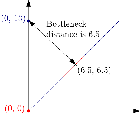

The bottleneck distance measures the similarity between two persistence diagrams. It is the shortest distance b for which there exists a perfect matching between the points of the two diagrams (completed with all the points on the diagonal in order to ignore cardinality mismatchs) such that any couple of matched points are at distance at most b, where the distance between points is the sup norm in \(\mathbb{R}^2\) (not the Euclidean distance).
This implementation is based on ideas from "Geometry Helps in Bottleneck Matching and Related Problems" [27]. Another relevant publication, although it was not used is "Geometry Helps to Compare Persistence Diagrams" [32].
The following example explains how the distance is computed:
