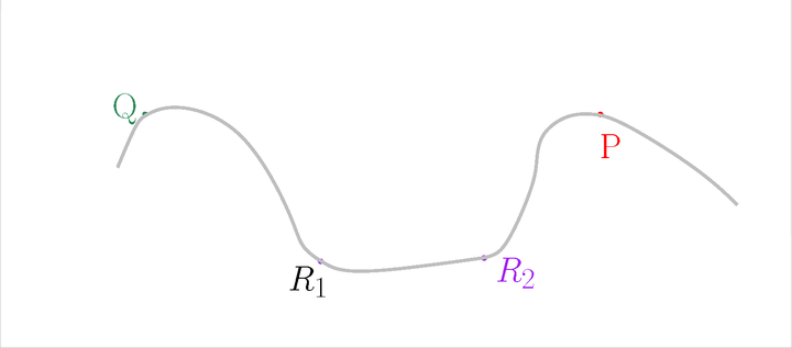

Let us start with the description of the Tangential complex of a simple example, with \( k=1 \) and \( d=2 \). The point set \( \mathscr P \) is located on a closed curve embedded in 2D. Only 4 points will be displayed (more are required for PCA) to simplify the figures.
The input

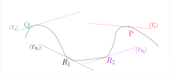

For each point \( P \), estimate its tangent subspace \( T_P \) using PCA.
The estimated normals

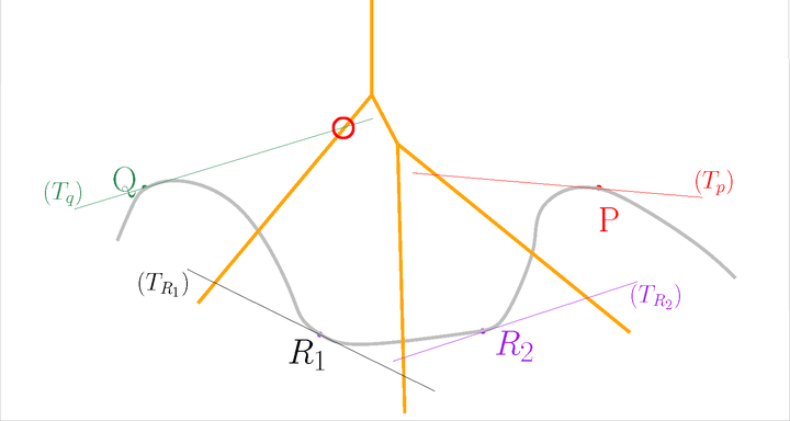

Let us add the Voronoi diagram of the points in orange. For each point \( P \), construct its star in the Delaunay triangulation of \( \mathscr P \) restricted to \( T_P \).
The Voronoi diagram

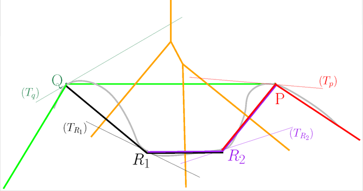

The Tangential Delaunay complex is the union of those stars.

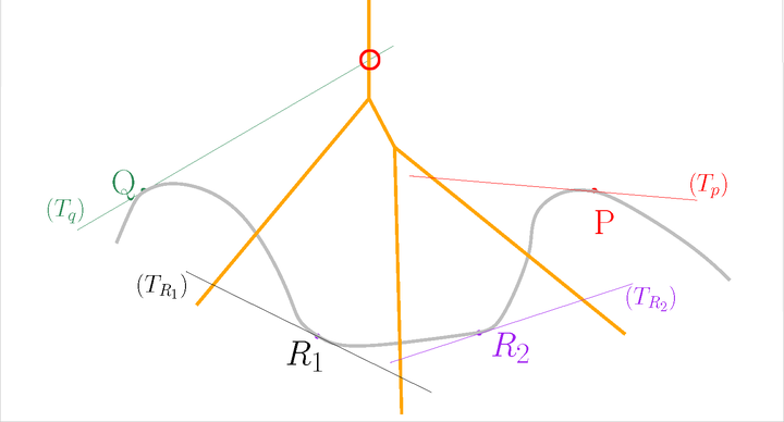

Let us slightly move the tangent subspace \( T_Q \)
After

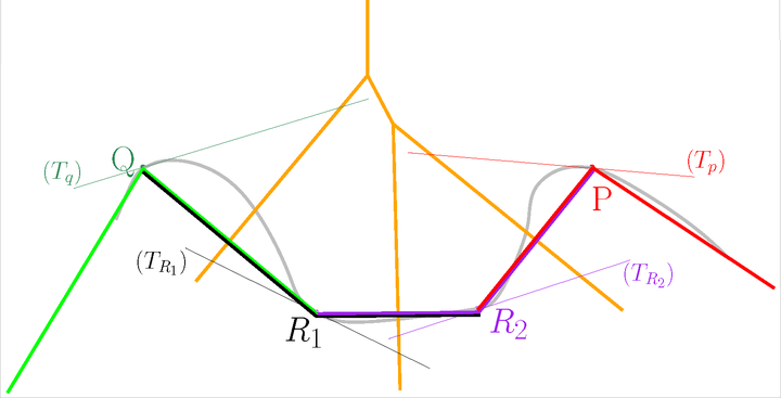

Now, the star of \( Q \) contains \( QP \), but the star of \( P \) does not contain \( QP \). We have an inconsistency.
After
