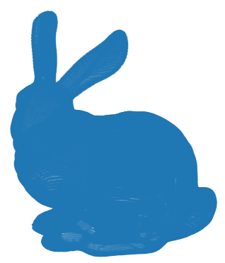

gudhi.datasets.remote.fetch_bunny(file_path=None, accept_license=False)[source]
Load the Stanford bunny dataset.
This dataset contains 35947 vertices.
Note that if the dataset already exists in the target location, it is not downloaded again, and the corresponding array is returned from cache.
Parameters
  • file_path (string) –
    Full path of the downloaded file including filename.
    Default is None, meaning that it’s set to “data_home/points/bunny/bunny.npy”. In this case, the LICENSE file would be downloaded as “data_home/points/bunny/bunny.LICENSE”.
    The “data_home” directory is set by default to “~/gudhi_data”, unless the ‘GUDHI_DATA’ environment variable is set.
  • accept_license (boolean) –
    Flag to specify if user accepts the file LICENSE and prevents from printing the corresponding license terms.
    Default is False.
Returns
points – Array of shape (35947, 3).
Return type
numpy array
_images/bunny.png
3D Stanford bunny with 35947 vertices.

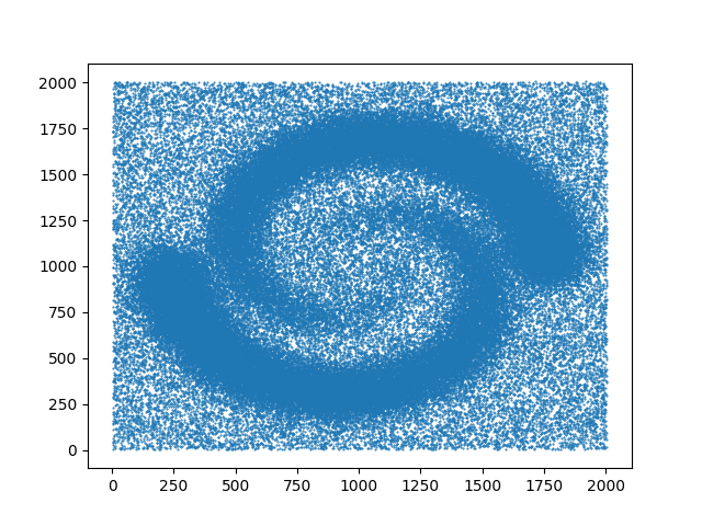

gudhi.datasets.remote.fetch_spiral_2d(file_path=None)[source]
Load the spiral_2d dataset.
Parameters
Default is None, meaning that it’s set to “data_home/points/spiral_2d/spiral_2d.npy”.
Returns
points – Array of shape (114562, 2).
Return type
numpy array
_images/spiral_2d.png
2D spiral with 114562 vertices.
