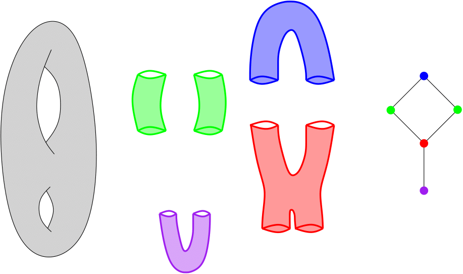

Nerve definition¶
Assume you are given a cover C of your point cloud P. Then, the Nerve of this cover is the simplicial complex that has one k-simplex per k-fold intersection of cover elements. See also Wikipedia.
Nerve of a double torus¶

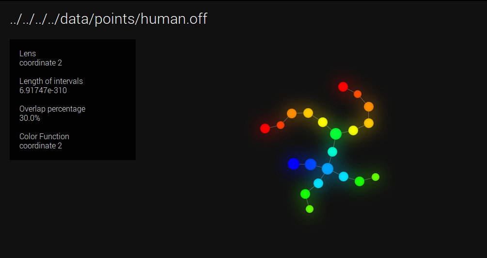

Using KeplerMapper, one can obtain the following visualization:
Visualization with KeplerMapper¶

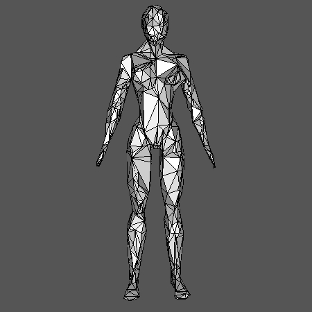

the program outputs SC.off. Using e.g.
geomview ../../data/points/human.off_sc.off
Visualization with Geomview¶

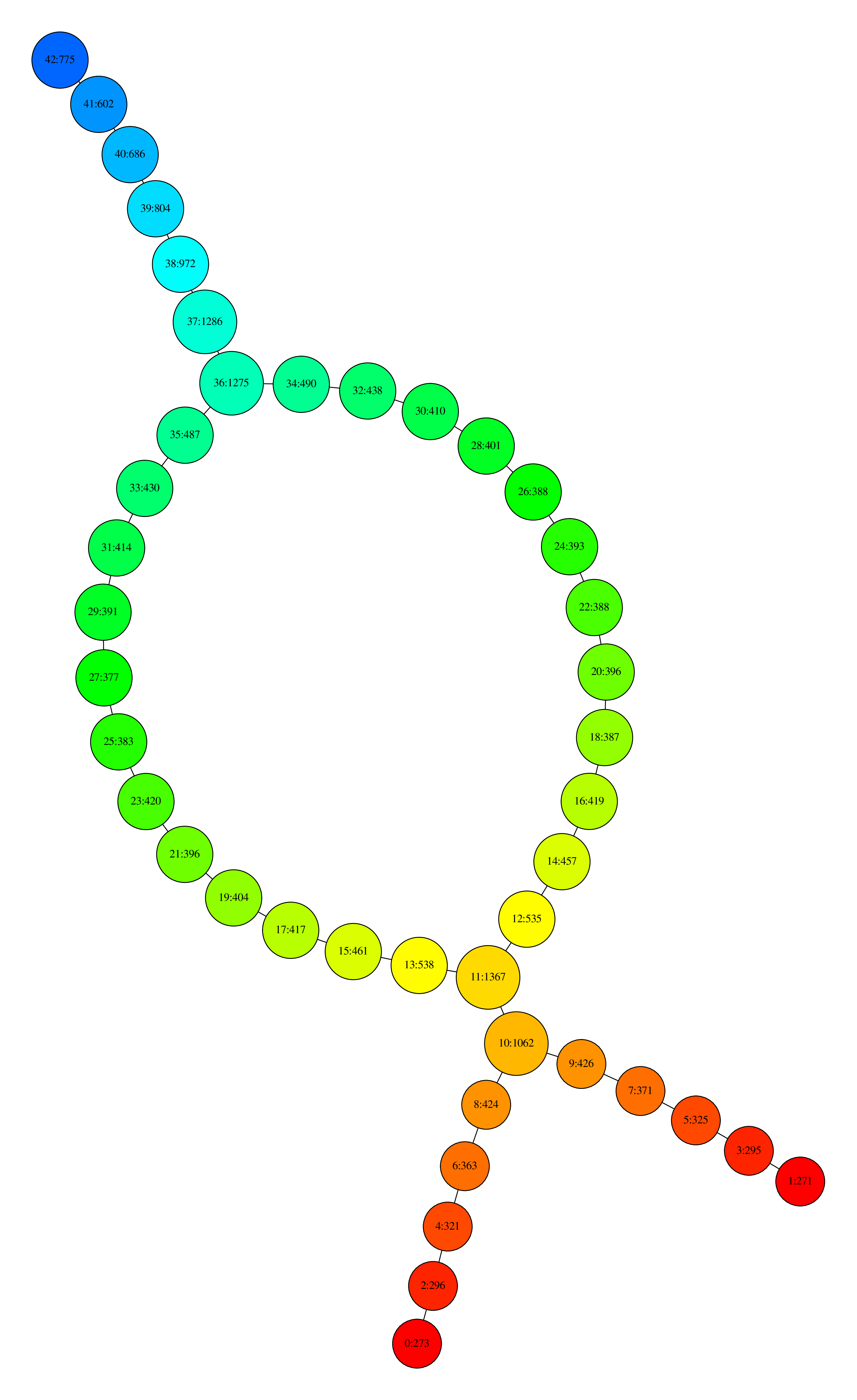

Functional GIC comes with automatic selection of the Rips threshold, the resolution and the gain of the function cover. See [9] for more details. In this example, we compute the functional GIC of a Klein bottle embedded in R^5, where the graph G comes from a Rips complex with automatic threshold, and the cover C comes from the preimages of intervals covering the first coordinate, with automatic resolution and gain. Note that automatic threshold, resolution and gain can be computed as well for the Nerve.
import gudhi
nerve_complex = gudhi.CoverComplex()
if (nerve_complex.read_point_cloud(gudhi.__root_source_dir__ + \
'/data/points/KleinBottle5D.off')):
nerve_complex.set_type('GIC')
nerve_complex.set_color_from_coordinate(0)
nerve_complex.set_function_from_coordinate(0)
nerve_complex.set_graph_from_automatic_rips()
nerve_complex.set_automatic_resolution()
nerve_complex.set_gain()
nerve_complex.set_cover_from_function()
nerve_complex.find_simplices()
nerve_complex.plot_dot()
the program outputs SC.dot. Using e.g.
neato ../../data/points/KleinBottle5D.off_sc.dot -Tpdf -o ../../data/points/KleinBottle5D.off_sc.pdf
Visualization with neato¶

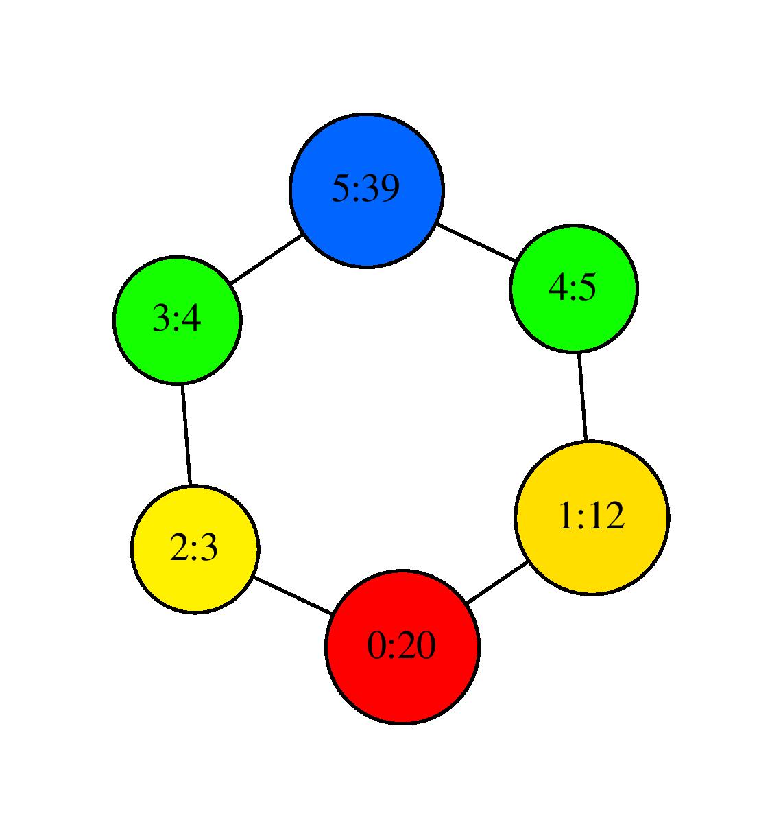

We also provide an example on a set of 72 pictures taken around the same object (lucky_cat.off). The function is now the first eigenfunction given by PCA, whose values are written in a file (lucky_cat_PCA1). Threshold, resolution and gain are automatically selected as before.
import gudhi
'/data/points/COIL_database/lucky_cat.off')):
pca_file = gudhi.__root_source_dir__ + \
'/data/points/COIL_database/lucky_cat_PCA1'
nerve_complex.set_color_from_file(pca_file)
nerve_complex.set_function_from_file(pca_file)
the program outputs again SC.dot which gives the following visualization after using neato:
