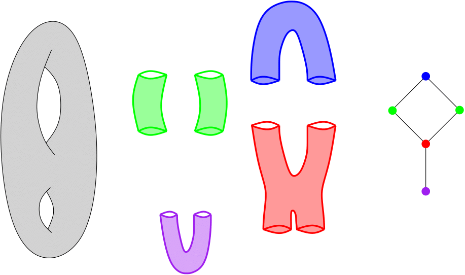

Nerve of a double torus

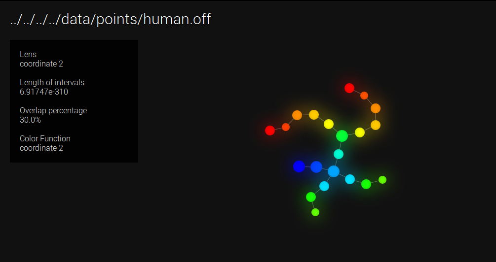

Using KeplerMapper, one can obtain the following visualization:
Visualization with KeplerMapper

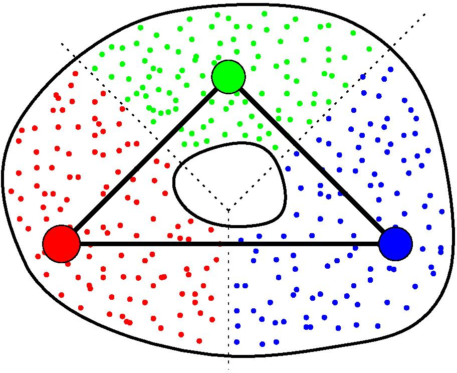

Again, assume you are given a cover C of your point cloud P. Moreover, assume you are also given a graph G built on top of P. Then, for any clique in G whose nodes all belong to different elements of C, the GIC includes a corresponding simplex, whose dimension is the number of nodes in the clique minus one. See [15] for more details.
GIC of a point cloud

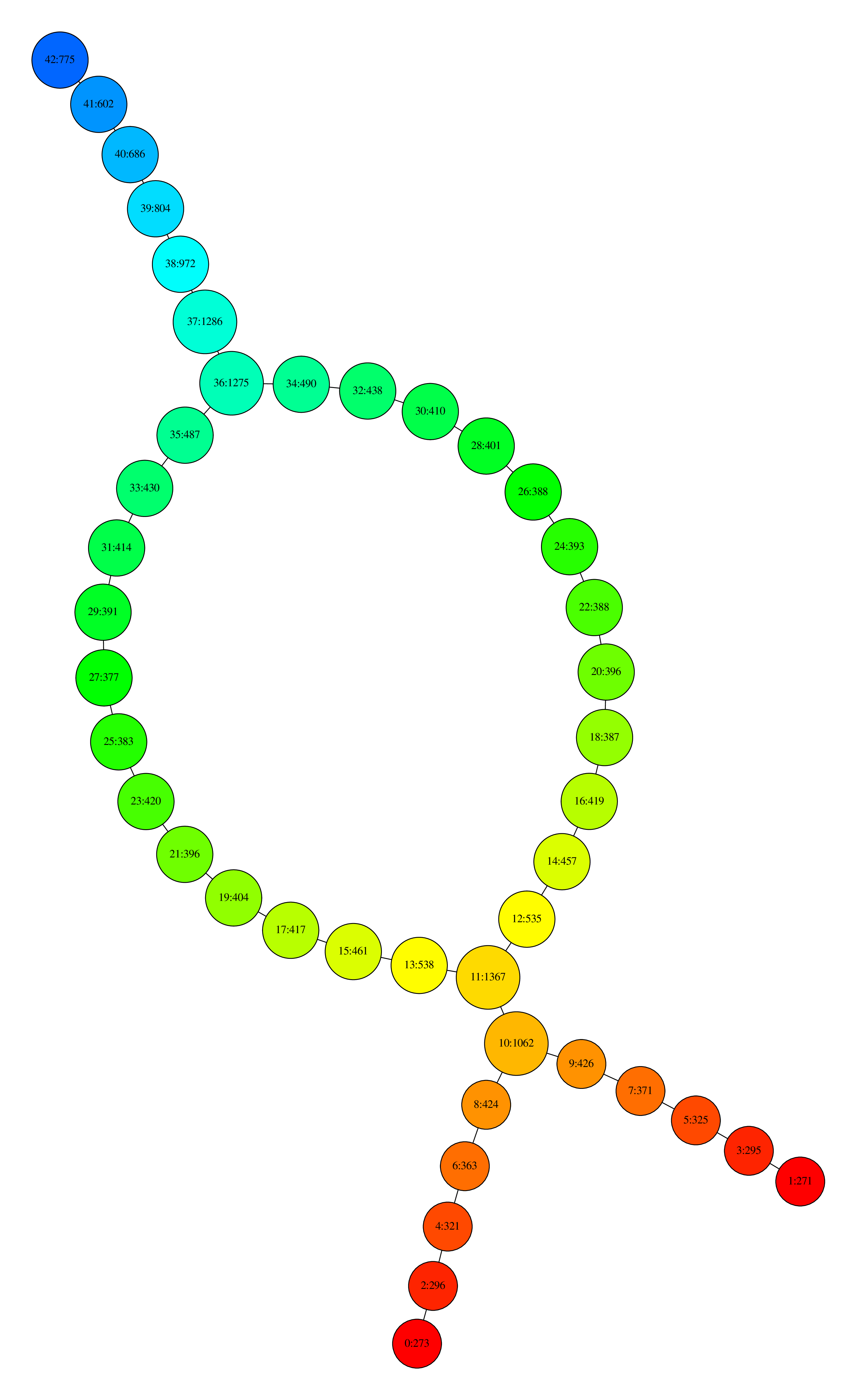

Visualization with neato
where nodes are colored by the filter function values and, for each node, the first number is its ID and the second is the number of data points that its contain.

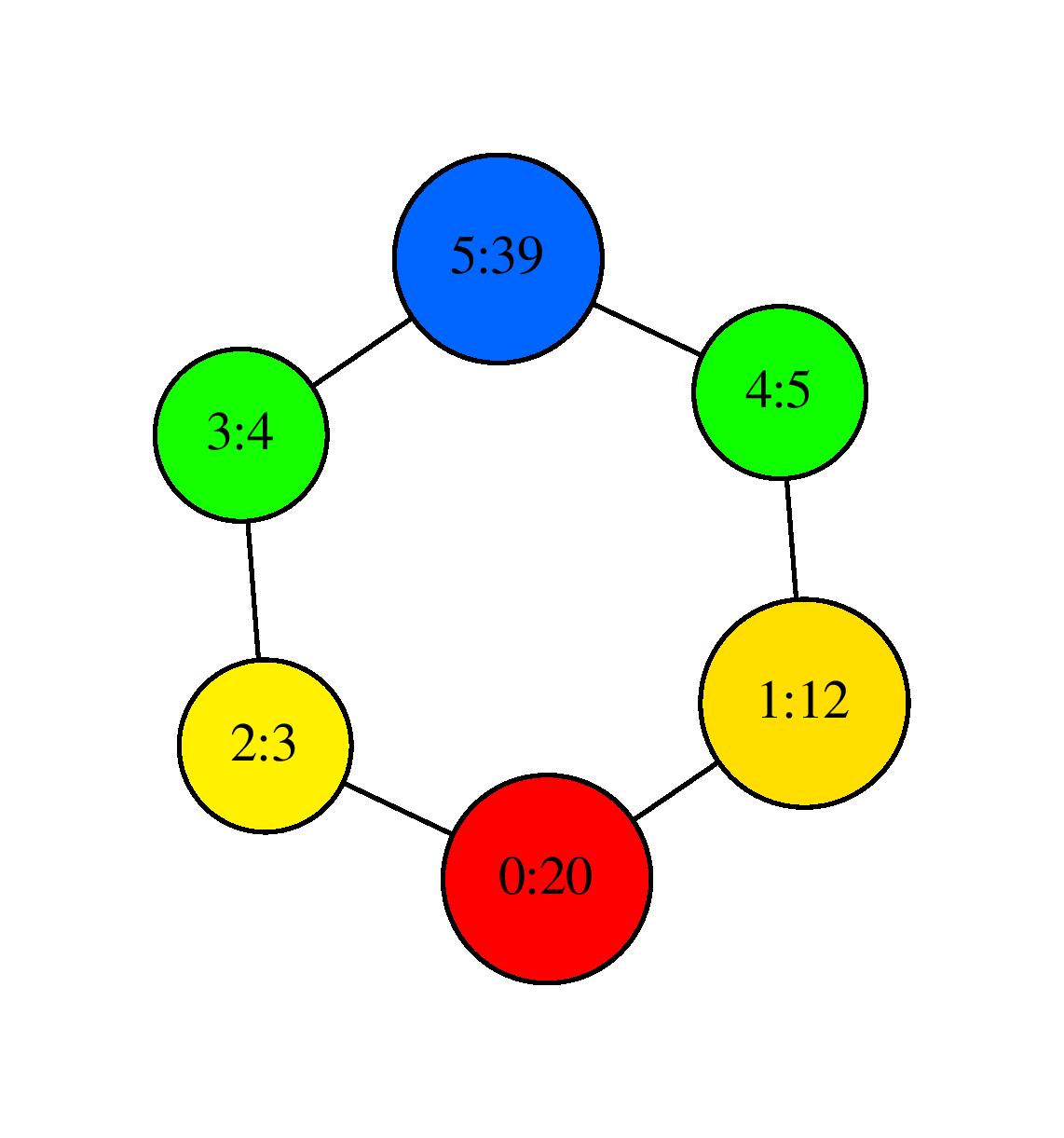

the program outputs again SC.dot which gives the following visualization after using neato:
