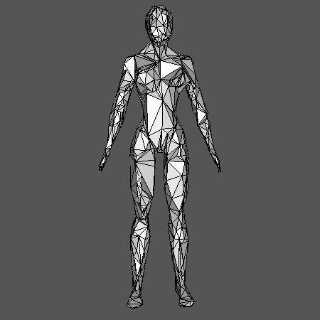

This example builds the GIC of a point cloud sampled on a 3D human shape (human.off). We randomly subsampled 100 points in the point cloud, which act as seeds of a geodesic Voronoï diagram. Each cell of the diagram is then an element of C. The graph G (used to compute both the geodesics for Voronoï and the GIC) comes from the triangulation of the human shape. Note that the resulting simplicial complex is in dimension 3 in this example.
import gudhi
nerve_complex = gudhi.CoverComplex()
if (nerve_complex.read_point_cloud(gudhi.__root_source_dir__ + \
'/data/points/human.off')):
nerve_complex.set_type('GIC')
nerve_complex.set_color_from_coordinate()
nerve_complex.set_graph_from_OFF()
nerve_complex.set_cover_from_Voronoi(700)
nerve_complex.find_simplices()
nerve_complex.plot_off()
the program outputs SC.off. Using e.g.
geomview ../../data/points/human.off_sc.off
one can obtain the following visualization:
Visualization with Geomview#

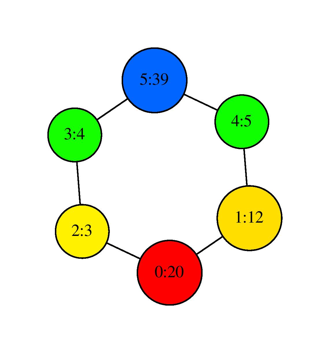

We also provide an example on a set of 72 pictures taken around the same object (lucky_cat.off). The function is now the first eigenfunction given by PCA, whose values are written in a file (lucky_cat_PCA1). Threshold, resolution and gain are automatically selected as before.
import gudhi
'/data/points/COIL_database/lucky_cat.off')):
pca_file = gudhi.__root_source_dir__ + \
'/data/points/COIL_database/lucky_cat_PCA1'
nerve_complex.set_color_from_file(pca_file)
nerve_complex.set_function_from_file(pca_file)
nerve_complex.set_graph_from_automatic_rips()
nerve_complex.set_automatic_resolution()
nerve_complex.set_gain()
nerve_complex.set_cover_from_function()
nerve_complex.plot_dot()
the program outputs again SC.dot which gives the following visualization after using neato:
