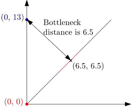

Distance computation
The following example explains how the distance is computed:
import gudhi
message = "Bottleneck distance = " + '%.1f' % gudhi.bottleneck_distance([[0., 0.]], [[0., 13.]])
print(message)
Bottleneck distance = 6.5
_images/bottleneck_distance_example.png
The point (0, 13) is at distance 6.5 from the diagonal and more specifically from the point (6.5, 6.5)
