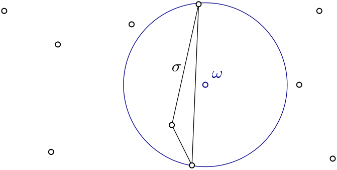

Witness complex is a simplicial complex defined on two sets of points in \(\mathbb{R}^D\):
Even though often the set of landmarks \(L\) is a subset of the set of witnesses \( W\), it is not a requirement for the current implementation.
Landmarks are the vertices of the simplicial complex and witnesses help to decide on which simplices are inserted via a predicate "is witnessed".
De Silva and Carlsson in their paper [22] differentiate weak witnessing and strong witnessing:
where \( d(.,.) \) is a distance function.
Both definitions can be relaxed by a real value \(\alpha\):
which leads to definitions of weak relaxed witness complex (or just relaxed witness complex for short) and strong relaxed witness complex respectively.
swit.svg
Strongly witnessed simplex
In particular case of 0-relaxation, weak complex corresponds to witness complex introduced in [22], whereas 0-relaxed strong witness complex consists of just vertices and is not very interesting. Hence for small relaxation weak version is preferable. However, to capture the homotopy type (for example using Gudhi::persistent_cohomology::Persistent_cohomology) it is often necessary to work with higher filtration values. In this case strong relaxed witness complex is faster to compute and offers similar results.
