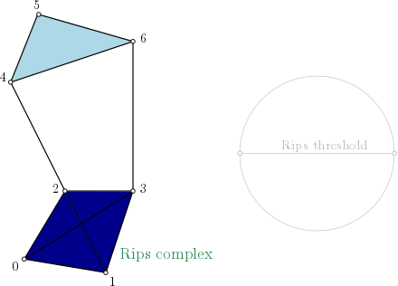

Rips-complex one skeleton graph representation
On this example, as edges (4,5), (4,6) and (5,6) are in the complex, simplex (4,5,6) is added with the filtration value set with max(filtration(4,5), filtration(4,6), filtration(5,6)). And so on for simplex (0,1,2,3).
