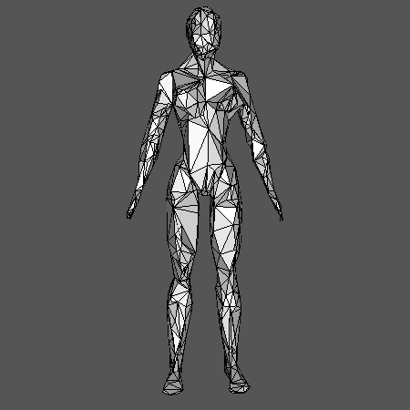

When launching:
$> ./VoronoiGIC ../../data/points/human.off 700 -v
the program outputs SC.off. Using e.g.
$> geomview ../../data/points/human_sc.off
one can obtain the following visualization:
Visualization with Geomview

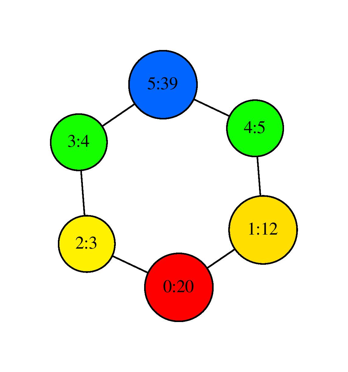

When launching:
$> ./CoordGIC ../../data/points/KleinBottle5D.off 0 -v
the program outputs SC.dot. Using e.g.
$> neato SC.dot -Tpdf -o SC.pdf
Visualization with Neato
where nodes are colored by the filter function values and, for each node, the first number is its ID and the second is the number of data points that its contain.

When launching:
$> ./FuncGIC ../../data/points/COIL_database/lucky_cat.off ../../data/points/COIL_database/lucky_cat_PCA1 -v
the program outputs again SC.dot which gives the following visualization after using neato:
Visualization with neato
