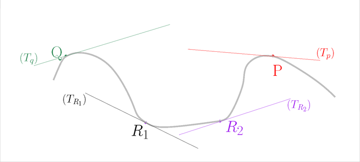

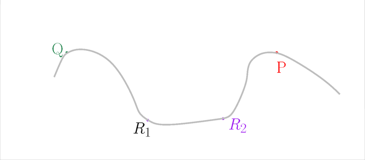

Let us start with the description of the Tangential complex of a simple example, with \( k=1 \) and \( d=2 \). The input data is 4 points \( P \) located on a curve embedded in 2D.
The input
For each point \( p \), estimate its tangent subspace \( T_p \) (e.g. using PCA).

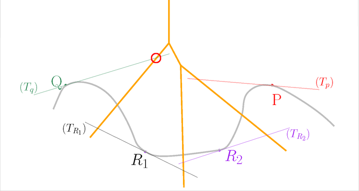

Let us add the Voronoi diagram of the points in orange. For each point \( p \), construct its star in the Delaunay triangulation of \( P \) restricted to \( T_p \).
The Voronoi diagram

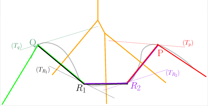

The Tangential Delaunay complex is the union of those stars.
In practice, neither the ambient Voronoi diagram nor the ambient Delaunay triangulation is computed. Instead, local \( k \)-dimensional regular triangulations are computed with a limited number of points as we only need the star of each point. More details can be found in [4].

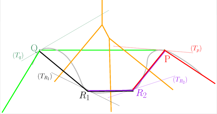

Let us slightly move the tangent subspace \( T_q \)
After
Now, the star of \( Q \) contains \( QP \), but the star of \( P \) does not contain \( QP \). We have an inconsistency.
After
One way to solve inconsistencies is to randomly perturb the positions of the points involved in an inconsistency. In the current implementation, this perturbation is done in the tangent subspace of each point. The maximum perturbation radius is given as a parameter to the constructor.
