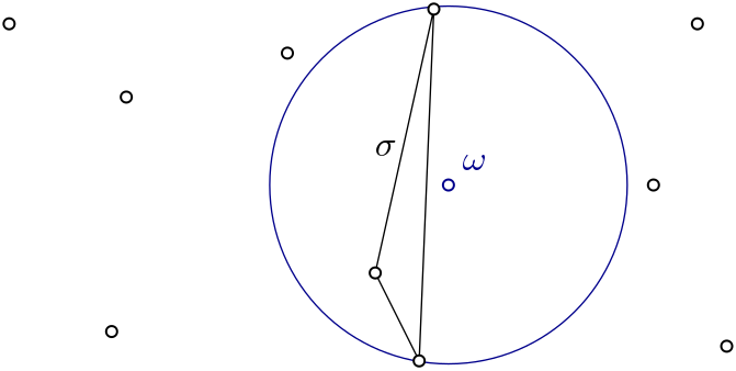

swit.svg
Strongly witnessed simplex
In particular case of 0-relaxation, weak complex corresponds to witness complex introduced in [8], whereas 0-relaxed strong witness complex consists of just vertices and is not very interesting. Hence for small relaxation weak version is preferable. However, to capture the homotopy type (for example using Gudhi::persistent_cohomology::Persistent_cohomology) it is often necessary to work with higher filtration values. In this case strong relaxed witness complex is faster to compute and offers similar results.
